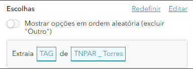

In this 123Survey, we are having trouble adding a dropdown/cascade list to the 'Location List' option, extracting attributes from a layer.
See, we are configuring the desired attribute correctly here.
When I view this option in a web application, everything works fine, and the options appear
However, when validating the same app on a mobile device, whether iOS or Android, this option disappears or fails to load.
Is there some config I miss?
