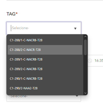

In this 123Survey, we are having trouble adding a dropdown/cascade list to the 'Location List' option, extracting attributes from a layer.
See, we are configuring the desired attribute correctly here.
When I view this option in a web application, everything works fine, and the options appear

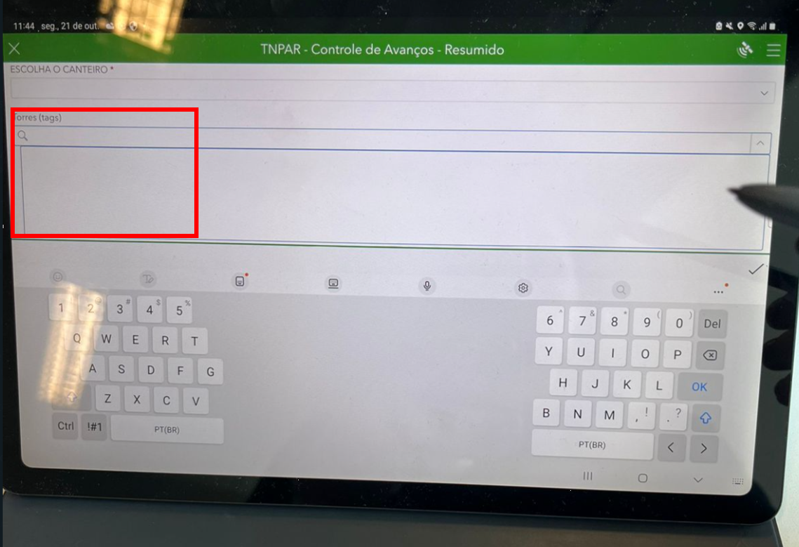

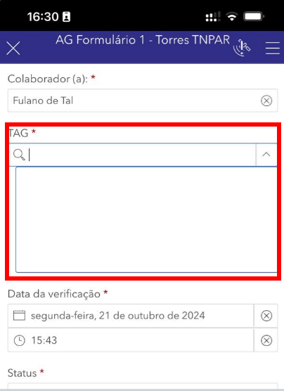

However, when validating the same app on a mobile device, whether iOS or Android, this option disappears or fails to load.
Is there some config I miss?

I am having the same issue.  Autocomplete works on a web application, but not on either smartphone platform.  I do not believe the csv is faulty.  If it were, it would not work on the web application correct?  I am unsure, and very new to creating public surveys.
