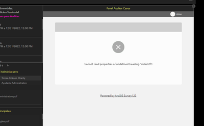

HI, i have a dashboard with a embedded survey in edit mode.
Was working fine but today when select a record in the list , the embedded survey say:
 Cannot read properties of undefined (reading 'indexOf')

Hi, well i found that when redering the form, in the developers tool of chrome says that is not found the attachments.
So i restart the services in my arcgis server and now is working again.
