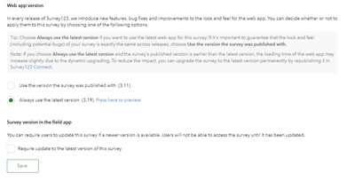

Have you tried setting the survey to the latest version (i.e. under Settings in S123 online)?  I would read Notes, first.
I created a survey from scratch and changed some fields to nothing unordinary. At first, I thought maybe the Excel warning (below) was causing the error in the console. But, then I set my survey to always use the latest version and the console error went away.
