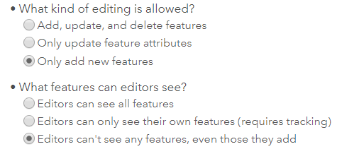

Hi all,
I have created a public survey with the following settings.
And, whenever an user attempts to attach an image the survey wouldn't submit (sits in outbox with an error).
But, when I change the settings to "editors can see all features;" it works properly.
Can you please look into enabling images with the above settings. As I'd like to keep all survey results private from the public.

Can you please check which version of Survey123 you are using?  When we released 2.4 initially, it was affected by this issue; 2.4.72 should have resolved that.  Additionally, the next update to ArcGIS Online will have better support for surveys with the permission settings you are applying.

The ArcGIS Online fix I mentioned is the backend fix that will be able to address it.  As a workaround, can you try working with the 'Editors can only see their own features' setting?  That should be able to address the issue and still limit the data to only items the submitter would already know.

You can do this by building the survey on top of a Feature Layer View which has a View Definition (Define Features) set to hide all features (e.g. WHERE OBJECTID < 1). In this Feature Layer View, you can set editing so users can only add new features. Only the Feature Layer View has to be shared with everyone, not the parent Feature Layer where all the feature can be accessed from.
