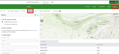

I created a survey using Survey123 Connect rather than using the website. I know you can create a report if you used the website. Is there a way to create a printable report if you created it through the app though?
My survey uses a feature service and has a repeater for images that's way I had to use Connect.

If you go to https://survey123.arcgis.com/ you will be able to draw a report by going to the Data tab of the survey and clicking on Report:

ab802319
Thank you, I didn't have any data yet in the survey so it wasn't showing at first. Now I see it!
