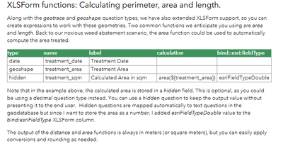

sum() is an aggregate function and needs to be outside a repeat.  You may look into Area, Perimiter, Length for calcs inside a repeat.
https://community.esri.com/t5/arcgis-survey123-blog/survey123-tricks-of-the-trade-lines-and-polygons...
