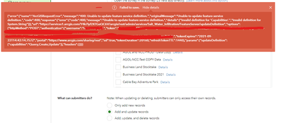

In the Suvvey123 settings under CollaborateShare Survey > What can submitters do?
The tick boxes are all empty:
When I enable the first record (Only add new records) and click on save, the page returns that the settings have been saved successfully. However, as soon as I refresh the page, nothing is ticked anymore.

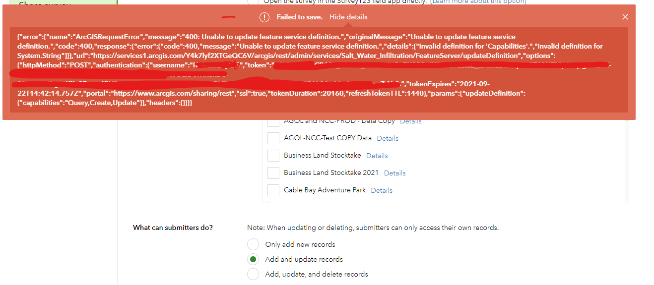

If choose either Add and update records or Add, update and delete records, I get following error message:
{"error":{"name":"ArcGISRequestError","message":"400: Unable to update feature service definition.","originalMessage":"Unable to update feature service definition.","code":400,"response":{"error":{"code":400,"message":"Unable to update feature service definition.","details":["Invalid definition for 'Capabilities'.","Invalid definition for System.String"]}}
