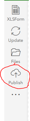

Ok, I'm trying to fill in the blanks. Hit save in your XLSForm. If you don't already have it open, open your survey in Survey123 Connect app. Do you see any errors? Or when you Publish your survey to AGOL from Connect are you seeing any errors?
GisAdmin6
I opened the xlsform and there was an error in a label. I changed it and published the survey again, everyting worked without errors, but im still having the same problem.
