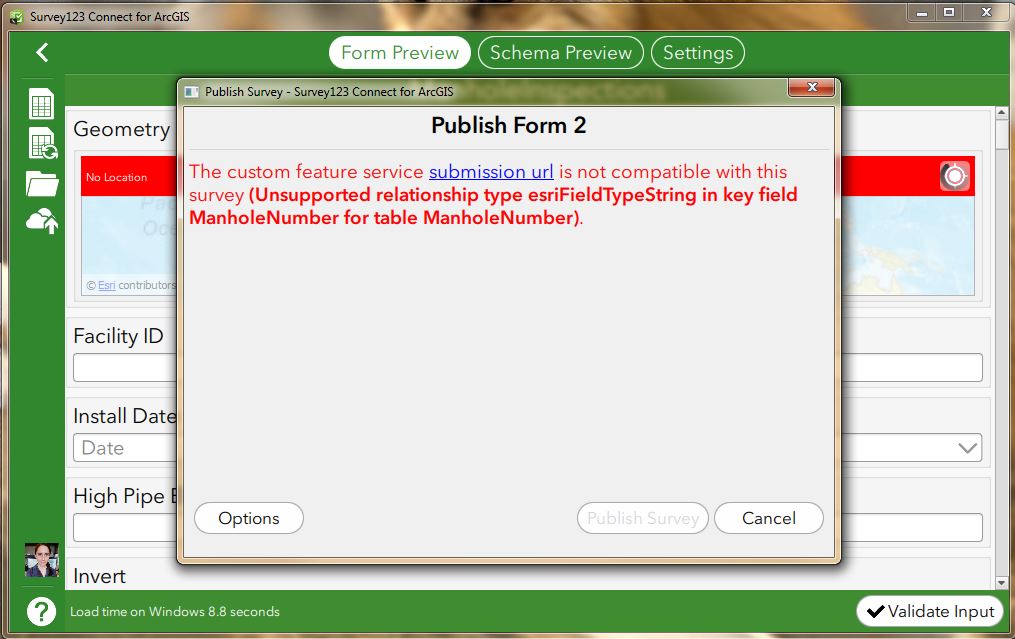

I am trying to use the Manhole Inspection solution to create an inspection form in Survey123 Connect, but I am getting an error when I try to publish it. I downloaded the solution's zip file, changed the source of the manhole layer to my own gdb, and published it as a service on AGOL. Everything looked great.
I then...

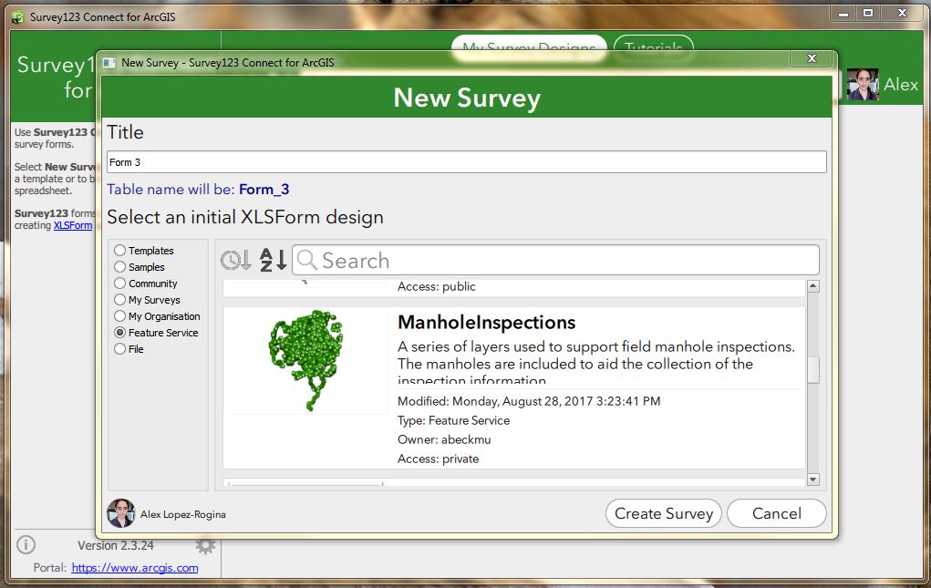

- Opened Survey123 Connect
- Selected New Survey
- Chose the ManholeInspections feature service that I just created
- The survey and XLS form was created
- I tried to publish it, and I got this error
I'm not sure what to do next... I'm a little confused by what it doesn't like. Does it not like the field being a string? It's the Foreign Key in the relationship class (FacilityID is the Primary Key), and our manhole ID's have numbers and letters in them so it has to be text. Does anyone have thoughts or advice on what I should do? Hopefully I've provided enough info to make sense.

Hi Alex.  Unfortunately, the Manhole Inspection Solution from the Water solution is not  designed to work with Survey123 for ArcGIS. The relationship-class included in the same geodatabase uses string fields (FacilityID and ManholeNumber) as the key fields.  In Survey123, if you want to include a repeat within your XLSForm, the underlying relationship class must use GUID/GlobalDs.
There  are  some alternatives here:
  • Modify the geoatabase schema to include a relationship class that uses GlobalID and GUID fields
  • Use Survey123 to work with either just the Manhole layer, or the Inspection layer.
