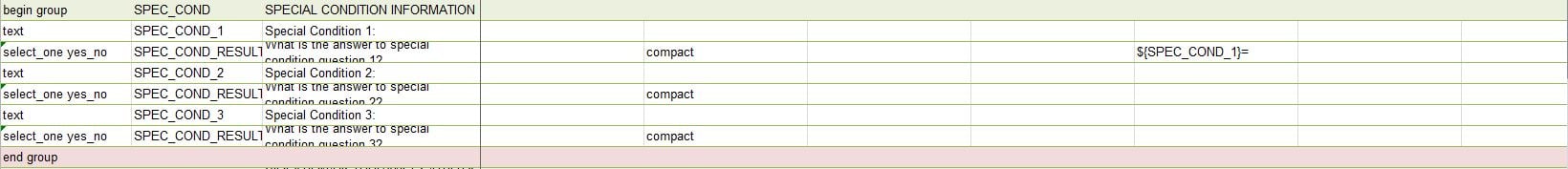

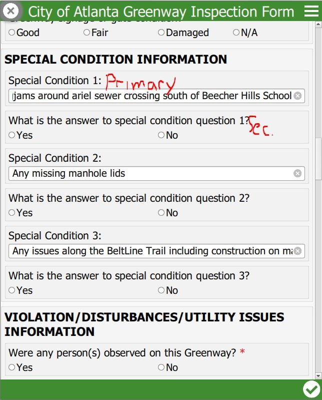

Using a custom URL feature in Collector to allow users to open an inspection form in Survey123 from the feature needing to be inspected. Configured to have fields come over into text fields in Survey123, that the inspectors must answer. Using the revelant field, can I make those secondary fields dependent on if the primary(linked field) is not null?
Survey with Primary and Secondary fields
XLS Form
IsmaelChivite
Esri Notable Contributor
Hi. Did you try adding something like string-length(${PrimaryQuestion})>0 into the Relevant column of your secondary question?
CarlHolt1
See ichivite-esristaff‌ this is why ya'll are the best and so very helpful. I looked on XLSForm.org and other help docs. That worked. Thanks as always.
