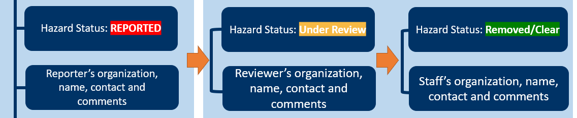

Here are questions and scenario we'd like to use:
- Question 'Hazard Status' has three choices: Reported, Under review, Remove/Cleared.
- 'Reported' is expected to be used for initial data collection
- 'Under review' and 'Removed/Cleared' are expected to be used during review process using collected data (edit existing survey).
- Each answer of Hazard Status will bring a group of questions to capture organization, name, contact, and comments using 'Relevant'
- Let's say someone collected data using 'Reported' status and entered all relevant information.
- During review, another person opened the submitted record using the form (either inbox/edit records), and updated its status to 'Under review' and entered his/her information and comments.
- Since 'Reported' is not selected anymore, it erased field worker's organization, name, contact and comments information entered under 'Reported'.
- We'd like to keep all information to see how hazard has been reported and cleared for data management perspective.
