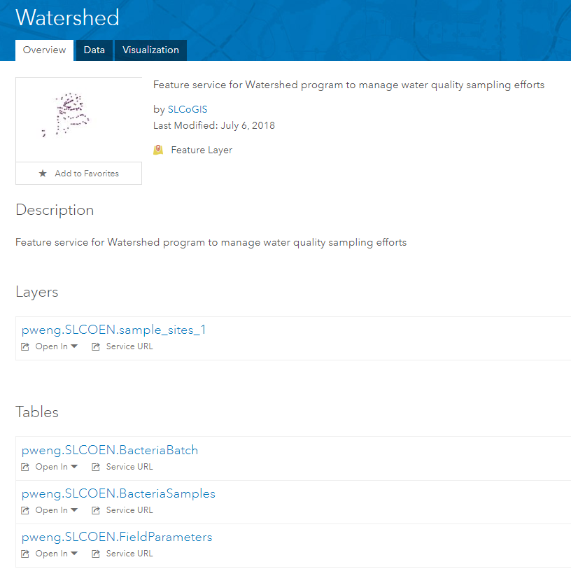

Here's the basic structure of my data in SDE:
Sample Sites (point data)
==> Related Table:  Bacteria Samples [1:M, SiteHasSamples, related on SITEID fields]
Bacteria Batch (table)
==> Related Table: Bacteria Samples [1:M, BatchHasSamples, related on GlobalID/ParentGlobalID fields]
What I want is a survey that populates the Bacteria BatchBacteria Samples tables only. But, since the Batch table is not related to SampleSites, it does not get included in the XLS form created from the existing feature service.  Here are my tweaks to the XLS to include Batch in the survey:

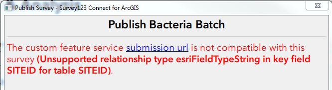

But it's not working. I've been working my way through each error that the survey snags on when trying to publish it in Survey123 Connect (v2.6.6).  Here's the current error:
I assume this is because I kept the samples fields in a repeat, and it thinks the repeat should be based on SITEID, but it's not anymore. As previously mentioned, I think I understand the problem but not how to fix it...or even if what I'm trying to do is possible.

  • Go into Connect and Create a New Survey from the Feature Service that contains your standalone table. Please make sure that your Feature Service actually has the table in it, even if it not related to any other layer.  We already know that Survey123 Connect will ignore the standalone table, but at least you will get the submission_url value populated in the Settings tab of your XLSForm.   The submission URL tells Survey123 the location of the feature service you want to hit and in your case, the value will be correct.
  • Now, in that same Settings worksheet you will find a column called FormID.  That column contains the name of the layer in your feature service that will be used as the parent layer of your survey.  The value will be incorrect in your case, because by default Connect simply looks at the first layer in your feature service.  In your case, you will want to replace the value with the name of your standalone table as shown in the feature service Services Directory or the Feature Service Item Details Page.

Important: Now, all the above is only valid if your feature service is compatible with Survey123, and Survey123 can be a bit picky!  The error you are describing indicates that your relationship is using string fields. Unfortunately, as of version 3.0 Survey123 no longer supports working with relationships unless they leverage GlobalID fields.  There is more info about this here: https://community.esri.com/groups/survey123/blog/2018/07/17/how-to-turn-supportsapplyeditswithgloabl...

Further to Ismael's comments, you need to make sure you have a GUID relationship between the Bacteria Batch and Bacteria Samples tables. I believe this is the cause of the error you are getting in Connect. You likely have GlobalID/GUID relationships between the other layers/tables, but possibly not these two?

If you are using SITEID as part of the relationship, as Ismael mentioned, bear in mind that you will have to use Survey123 Classic. As of 3.x, relationships have to be setup using Global ID's.
