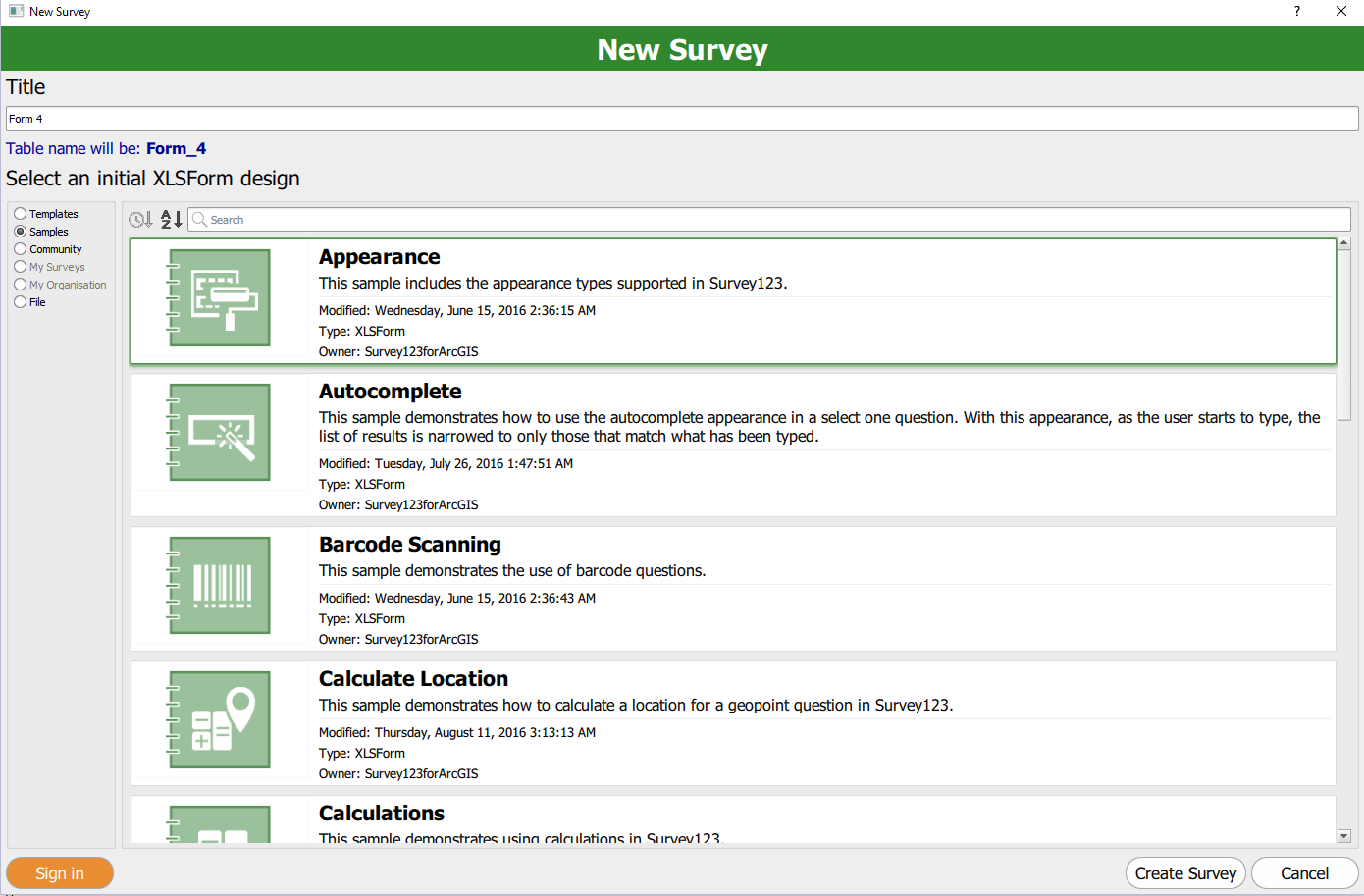

I have looked at the ESRI UC 2016 video on Survey123 creating Smart forms but I need some place I can go to, be it video or document which has the commands available and how to use them effecvitvely
Hi Cheryl,
I find the samples within Survey123 Connect very helpful. To access them, open Survey123 Connect and click on 'New Survey'. Then you can click on Samples on the left. They include great examples for calculations, cascading selects, expressions, etc.

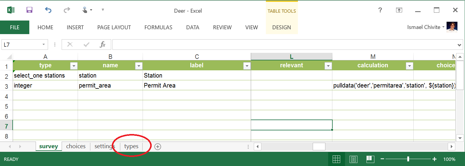

On top of all the great suggestions above, when authoring your XLSForm, you can also look at the Types worksheet where you will find a quick guide of the most common question types, appearances and formulas you can use, right in Microsoft Excel.
