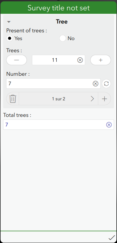

When users were filling out the survey recently, they noticed that moving back and forth between repeats to make corrections locked the calculations and the totaled sums could no longer be updated. I have tried calculationMode = always.

This "refresh" button indicates that either someone typed into the field, or something more annoying is going on (could be a few vague things...). Clicking the button should show the correct values.

SébastienDebar
It makes no difference, on the Connect or on my phone.
