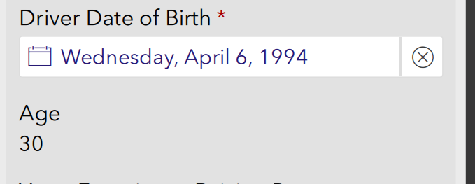

I am having a heck of a time reconciling a form I created using connect. Everything works perfectly in the test environment and on a mobile device. However, the web form detects an error with calculating an age based on today's date and a driver's DOB. I have no problems on a mobile device though.
The first pic is from the test environment of Survey 123 Connect which calculates the age correctly as does the published mobile app.

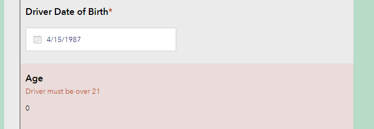

This is on the web form and I get this error.
Below is the xls form. I read that concat may solve this (it didn't) or converting to a string might do it (it didn't.) I don't mind keeping this as a purely mobile application, but there are times where it's more convenient to do this on the web. Any suggestions?
JenniferAcunto
The Survey123 web app ONLY supports decimal time.
Dates and Time in Survey123
