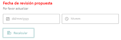

I have a similar question.
I need to pass a value from one question in the Parent Table (principal survey) to all the related values in the Child Table (repeats).
  • In the first stage, the user defines the hospital (parent table) and the equipment (child table) as a relation 1-N.
  • In the second stage, another user defines the date (parent table) of the visit to the hospital.
We need to pass the visit date defined in the parent table to all the equipment. This works very well in the app, using the recalculate button, but in the webform the button gets freeze.
Our workflow is necessary to use Webforms and the App, we designed in Survey123 Connect v. 3.12.232.
 We don't test in Early adopter yet, because this will be in production as soon as possible.
Thank's in advance.
JodyZhengLiu
Hi @HaroldHerrera1 ,
Thanks a lot for the feedback. There is a known issue for using the recalculate button within repeats(relate table) in the web form. We have it logged on our dev backlog and the target fix date is the end of this year.
