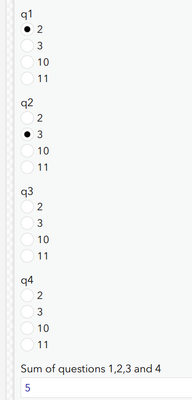

Hello. Based on what I understand of your question, I created a choice list named 'score' and used it in 4 select_one questions as shown below.
 The formula then works just fine :
Hope it can helps !
Cheers

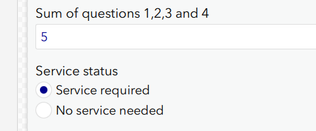

Dear Christophe AGNES,
Thanks indeed helpful. I just don't want to  sum  but also create relationship if  score less than 10  service required if more than 10  No  service  needed
Chris_976
Okay, then you just need to add a select_one question with choices set as 'service_required', 'no_service_needed', set "read only" attribute to 'yes' and use the "calculation" attribute if(${sum}<10, 'service_required', 'no_service_needed').
That will calculate automatically the status based on the sum above.
