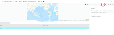

Editing the data directly in the table won't rerun any calculations since the calculation is on the Survey123 form level. In the Data tab of the Survey123 website when you select a record if you select the pencil icon on the top of the pane that displays on the right you will edit the record in the Survey123 web app.
Editing here should either directly update the calculation or provide you with an option to recalculate the value.

AbigailEbelherr
Ok, that actually solves my situation neatly enough.  Thank you.
