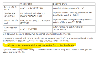

Looks like you are using EPOCH time,  that doesn't work on the web. Convert that calculation to decimal date and it should work on Connect/Field App and Web.
https://community.esri.com/t5/arcgis-survey123-blog/dates-and-time-in-survey123/ba-p/895528

Thank you Neal. Got it working with this calculation:
int((decimal-date-time(now()) - decimal-date-time(${wait_time})) * 24 * 60 )
