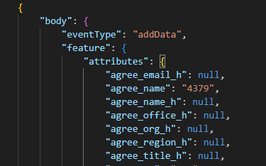

This is an example of calculates not working:
abureaux_0-1686838449823.pngabureaux_0-1686838449823.pngabureaux_1-1686838466649.pngabureaux_1-1686838466649.png
The user made a selection which was saved (agree_name), but nothing was found with pull data. This user submitted 10 items. Half didn't work. The other half did.
Edit: Seems like there are two separate issues here. This particular project's lack of data is related to a bug. I have created a separate post regarding this bug.

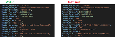

Here is a comparison of some Meta Data...
The only difference between the submission that worked and the one that didn't work is the "header_utc_date" field. This is a hidden field that the user cannot change. Despite "header_mode" saying that this is a "new" submission, I would guess that the user actually went to the Sent Folder and copied a previous submission for a new survey.
