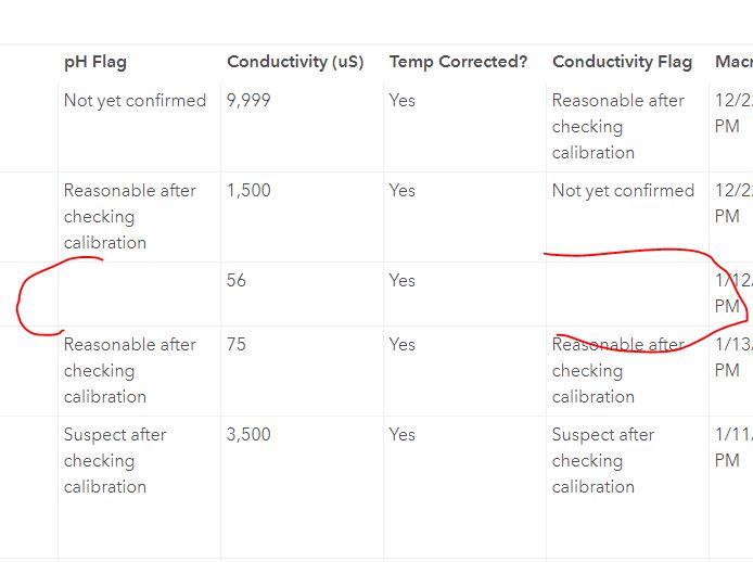

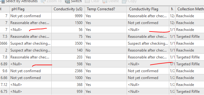

In the past the fact 123 uses "" and not null has been an issue.  But now I am seeing that Pro is showing "" as Null somehow.  I am looking directly at the hosted feature service in both.  This actually means needing diff code in AGOL vs Pro to check for them.
In AGOL
In Pro
I am not seeing a domain or anything.  How is this happening?
