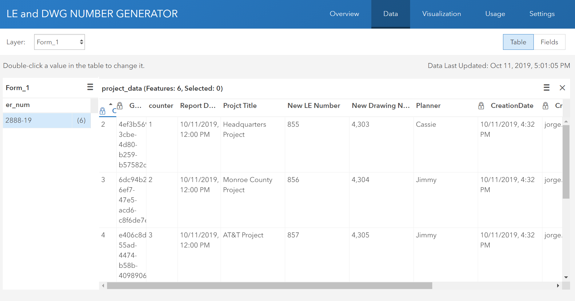

Update: I saw in the log that there was a problem with the newly added counter field not being present in the feature service, so I deleted the feature service and the updated survey did publish.
Now I'm getting a different kind of problem, and that is when I close the survey everything resets and the only reference I am left with is the project values in the .csv.
Is there a way to read the last record in the feature service to use as a reference?
Or is there a way to read the last record from the Sent section of the survey page in Survey123 for ArcGIS from the survey's XLSForm?

The second dilemma is more of a design issue. I read the last project numbers from a .csv and build up on it.
Source
Survey gets last survey from .csv.
Running records.
Problem is when the survey is closed, the sequence is broken. And I'm back to whatever is in the original source .csv.
A possible solution would be writing the last record to the .csv--this would require manual work or a script, and I don't know how to read the FS with a script yet. Another would be reading the last record on the FS from the XSLForm and build up on it, but I don't know that there is a function that will do that.

Currently dynamic lists or reading a list from feature service or other source is not supported. There is no way to do this out of the box from the xlsx file.
However, we currently have support for JavaScript functions using pulldata() in beta and available in the Early Adopter Community. I suggest you take a look at the documentation and you may be able to write a JS function that does what you need and return the value you are after. Keep in mind it is a beta feature and there are some limitations.
