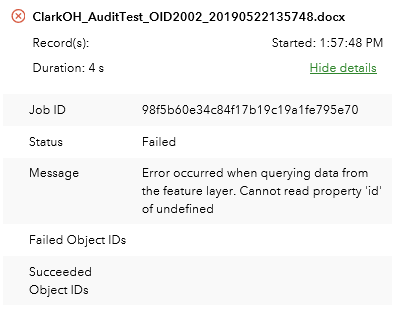

All of the above works fine; however, when I try to publish (beta) reports for this survey using the sample template provided by Survey123, I get "an error occurred while generating report" reading "Error occurred when querying data from the feature layer. Cannot read property 'id' of undefined":

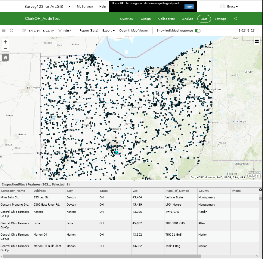

When I access this survey from the Survey123 Website, the surveys look different than they were during testing on hosted layers. At this point, no related records exist, however, the "Record Count" for the survey is that of the existing point features.
When I click the "Data" tab, it indeed displays the existing point feature's attribute table, whereas previously it displayed the first related table's attributes.

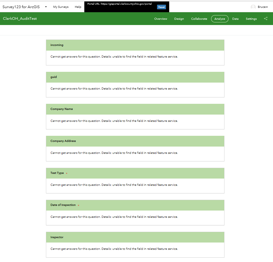

In addition, when viewing the "Analyze" tab, the first related table's questions all have "Cannot get answers for this question. Details: unable to find the field in related feature service."

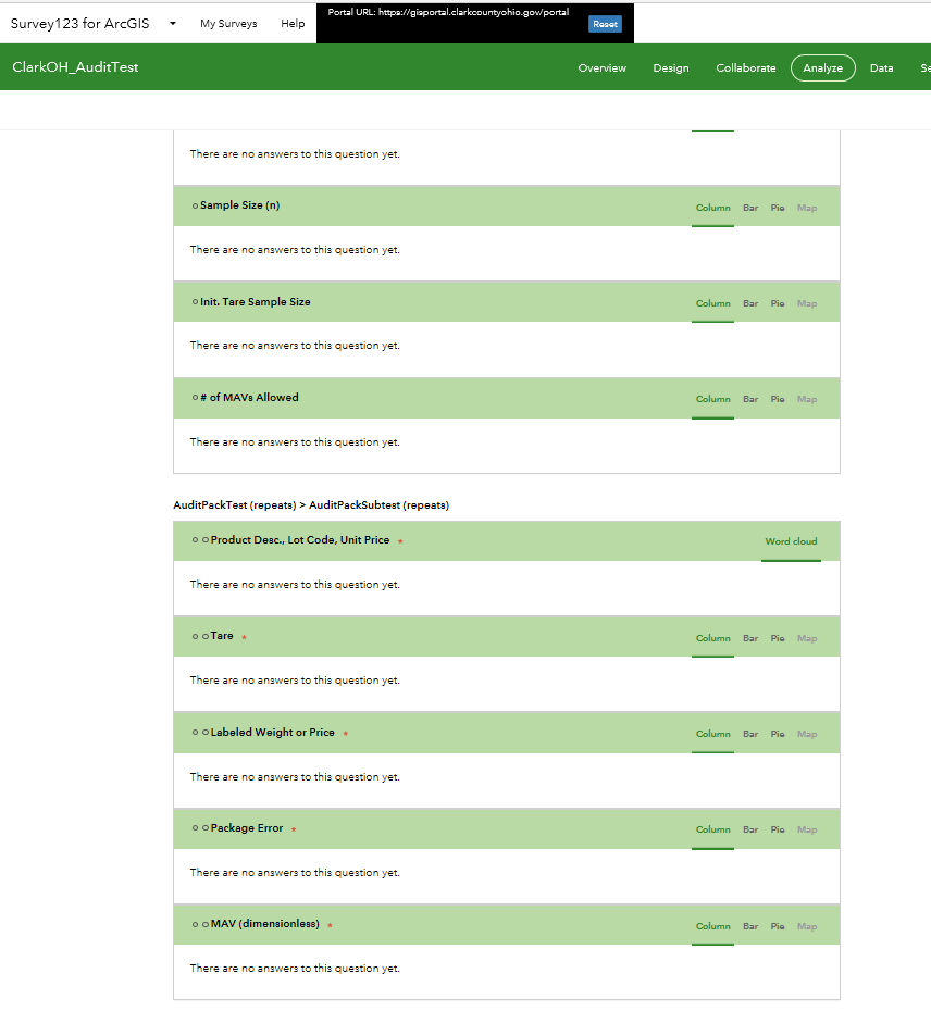

To work around this, I added a "begin/end" repeat for the first related table and set the 'form_id' to the related table's name (i.e.: "AuditPackTest"), which appeared to fix the "Analyze" table questions, partly, but seems to mess up the related table names 'squashed' into where the second related table's (i.e.: "AuditPackSubtest") headers were:

This doesn't seem to fix the "Data" tab, though, which still displays the existing points/point data, which did not previously occur. Why is it pulling this data when it's not part of the survey?? Ultimately, it seems the survey123 website is pulling from the parent feature class in ArcGIS Enterprise with Portal, but correctly pulling from the first related table when using a hosted feature layer.
