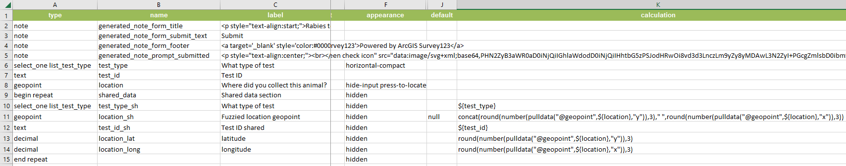

I can set up a new survey from my feature class, using the historic data to create the appropriate fields and field types in Survey123 Connect. I created a hidden repeat within my survey to create a child layer that contains a rounded geopoint, and copies the fields I want to share from my parent feature class. This is great - I can then create a hosted feature class view layer from the child layer, filter to the time and records I want, and share this with our partners.

Any ideas for how to append the historic data in the child layer? Maybe there is a way to force the feature class to recalculate any fields that are caculations? Or - how to do this a different way? I could simply use a feature layer view of the original feature class if only I could add a calculation on the geopoint feature!
Here's a screenshot of my test Survey's xlsx form. Maybe there is a way to force the child layer's data to re-calculate? The child layer will only ever have copies or calculations of fields that exist in the parent layer.

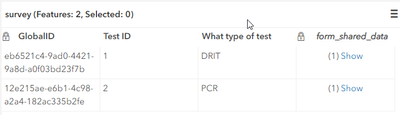

Now, open both of your AGOL feature classes in ArcGIS Pro from your "my content" section. You will need to update the ParentGlobalIDs of the child layer to match the GlobalIDs in the parent layer. Ensure both layers are sorted by the unique ObjectID (or in the same order) and then go to the parent layer and copy the GlobalIDs by clicking the first one, pressing shift, clicking the last one, right-clicking and pressing "Copy". In the child layer, select the entries in the "ParentGlobalID" field in the same way, and then right-click and PASTE. It may be safer to do this with a join but I was working with a test survey with two records 🙂 If you've done this correctly, you should be able to navigate to your parent layer's data from the Overview section and see that there is a form attached to each record:

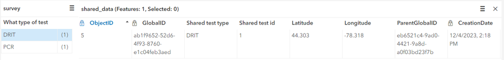

and if you click on the record, the related data should appear:
