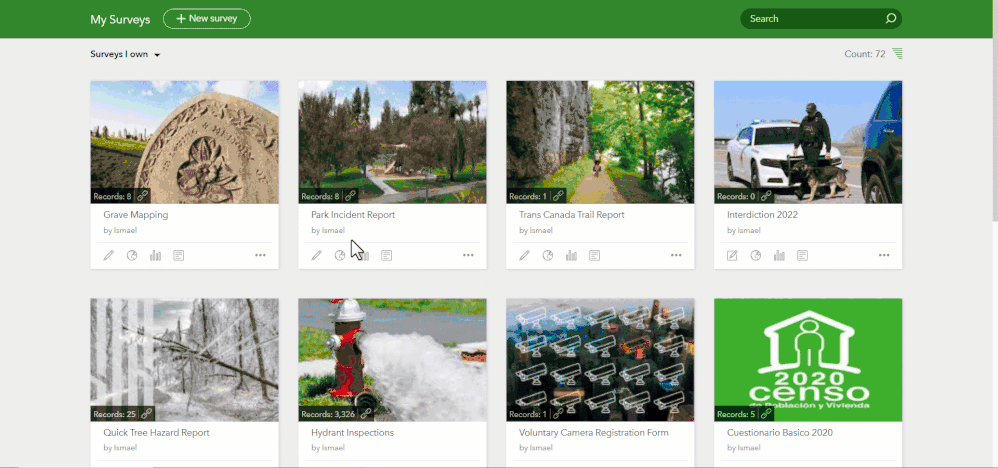

    • Go into survey123.arcgis.com and click on your survey
    • Open the Design tab
    • Click on Options
    • Set the auto-refresh policy (you can choose 0 seconds if you like)
    • Publish
