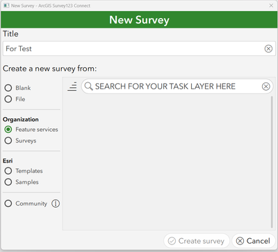

NICK_COG
Our organization used this for external divisions to submit work orders to a central irrigation team.
You can create a Survey from an existing feature class (your task feature class that is fully configured/ready to go) and the possible assignees will be created in a list automatically, then you can use a regular default/calculation to determine who gets the task.
