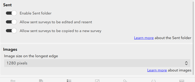

Hi Megan,
In Survey123 Connect in the options settings you have the ability to limit the pixels of a captured photo like so
Although I'm not sure whether this only works for photos being captured within the form itself or if it also compresses images that are being attached but have been captured separately (i.e. in the camera app).

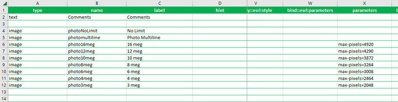

You can control this in the form now giving a size.
Like this in the paraeters column  max-pixels=4920

My post above will do that.
