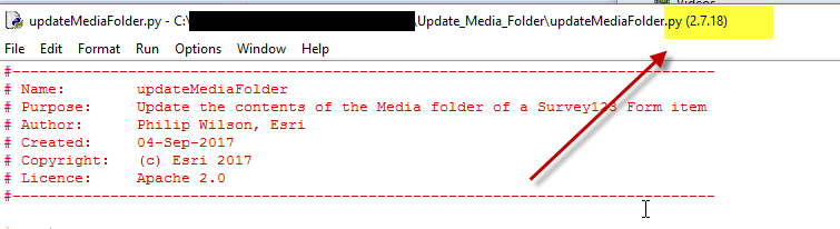

Im confused....I know I have the correct Credentials but keep getting coming up with a NULL for the token I am trying to get via the script.
This returns NULL...any thoughts
print "token: " + json.dumps(agol_helper.token)
NOTE: I have ArcMap 10.8.1 installed.  I have python 2.7 and python 3.4 on my machine.  Could this be causing the issue?  If so is there a way that I can specify to use python 2.7?
It appears I am using 2.7.18

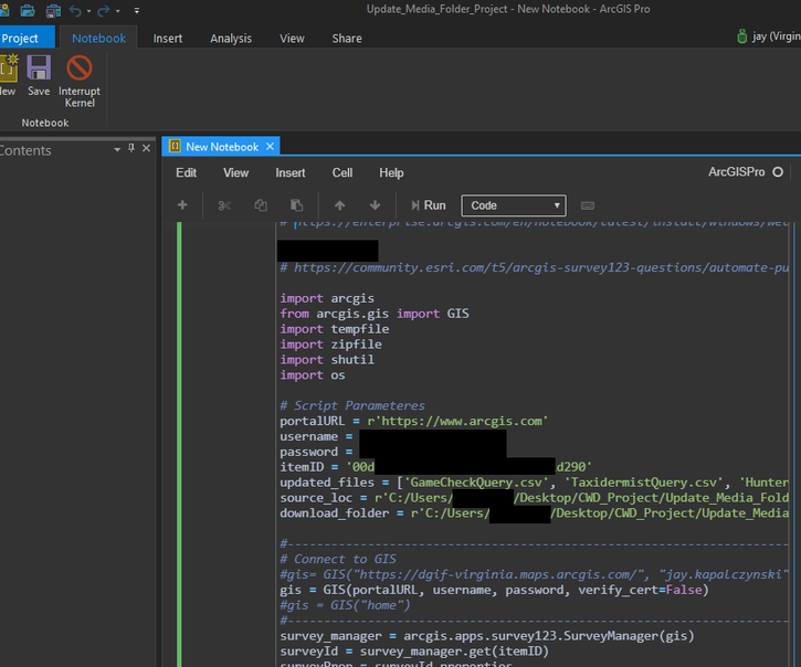

OK I think I have this working from ArcGIS Pro on my Laptop....it appears to be updating and uploading this to AGOL.
Most Important
How do I automate it to run when I want it to.  I am new to using Pro and it appears to be baked into an ArcGIS Pro project?????

So if I have the code baked into an ArcGIS Pro project in a "New Notebook" tab how do I automate it to run nightly.
It appears I can no longer use a .py file and use Task Scheduler to run it nightly.
