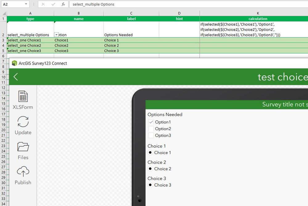

This is the calculation:
if(selected(${Choice1},'Choice1'),'Option1',
if(selected(${Choice2},'Choice2'),'Option2',
if(selected(${Choice3},'Choice3'),'Option3','')))
I am not able to figure out how to solve it.
Thanks!

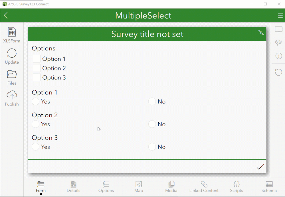

Hope this helps. XLSForm attachedHope this helps. XLSForm attached
See attached XLSForm example
