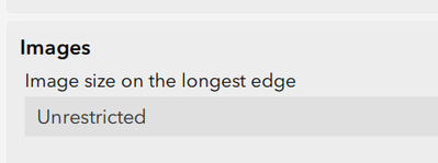

Have you set the images size to Unrestricted in the Options tab of Connect?
Also we set iOS to Most compatible otherwise it is stripping the Exif info on us.

And @DougBrowning I updated the setting to Unrestricted and it also doesn't seem to help (And my understanding of this is it shrinks the image uploaded to that size, not that it limits what image can be selected though?)
