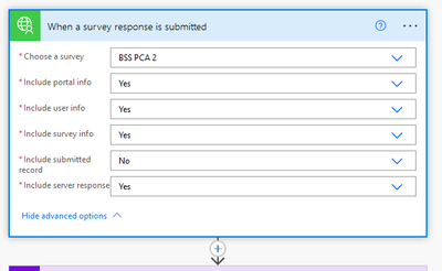

I have a very large survey (well over the 1024 soft limit). This was causing Power Automate to give me an error (same as yours) and prevent me from saving.
I set Include submitted record to No in the Trigger and the flow saved instantly (You can also edit the webhook in the S123 web page):

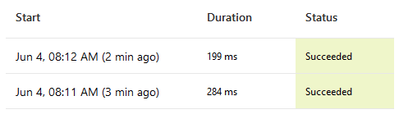

Any changes you make to the flow trigger "When a survey response is submitted" (e.g., toggling "Include submitted record") will require a survey update. Without that update, the flow will not trigger.
I did a quick test to see if anything changed, and both runs (one each for "Include submitted record" set to yes and then no) worked as expected after applying the appropriate survey updates.

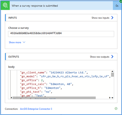

I just looked at the initial response for my large survey, and I can see all my data and I am able to call on these dynamic content:
What is the issue you are seeing exactly? Maybe I am misunderstanding.
