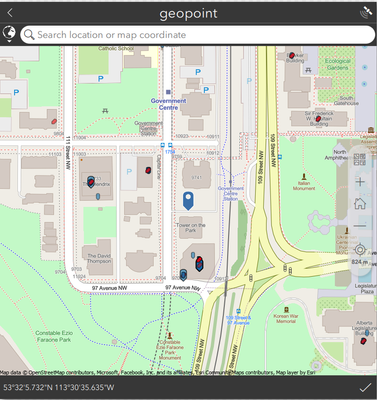

  1. Set up a web map in Portal (You can use your survey as the point data).
  2. In Connect, go to "Linked Content" tab (along the bottom) > "+ Link content" > "Online map" > search for and add the map you created.
  3. Still in Connect, go to the "Map" tab (along bottom) > click the "base map" selector button (located in the map preview area and above the + and - buttons) > select your map.
  4. Now, when you open your geopoint question, you should see all of the points.
E.g.,
