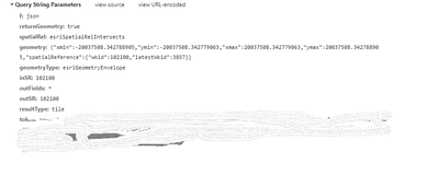

If the filter works on map viewer, then could could you please send us a screenshot of the fields of your main feature layer, like this one:
Could you please open your network panel on the developer tool, and then apply the filter again. There should be a failed query request shown in red, and click on the request to see the details? Scroll to the bottom of the header tab, and send us a screenshot of the Query Strings Parameters (please blur the token for safety), and then go to the response tab, expend all section and send us a screenshot of that.

Ruth_JiatengXu
Hi @BabatopeAdebajo1
Unfortunately, we still cannot identify the issue. It seems like some queries may have the 200 status but return invalid result. If it is possible could you please open the network panel, while the network panel is opened apply the filter again, and then export the request in the network panel using "save all as HAR with content". Please send the HAR file to my email jxu@esri.com , and we will try go through all the request to see which request causes the issue.
