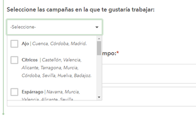

It works correctly but the apparence in the question is of default minimal type and I would like to see all options directly.

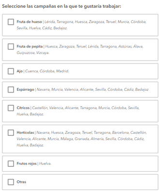

I would like it to be like this:

Hello @Oretana_,
The screen capture of the XLSForm is quite blurry and I'm not able to get a good look at what you have in the appearance column, but you can remove the minimal appearance from the appearance column in the XLSForm and that should display the choices as you are expecting.
