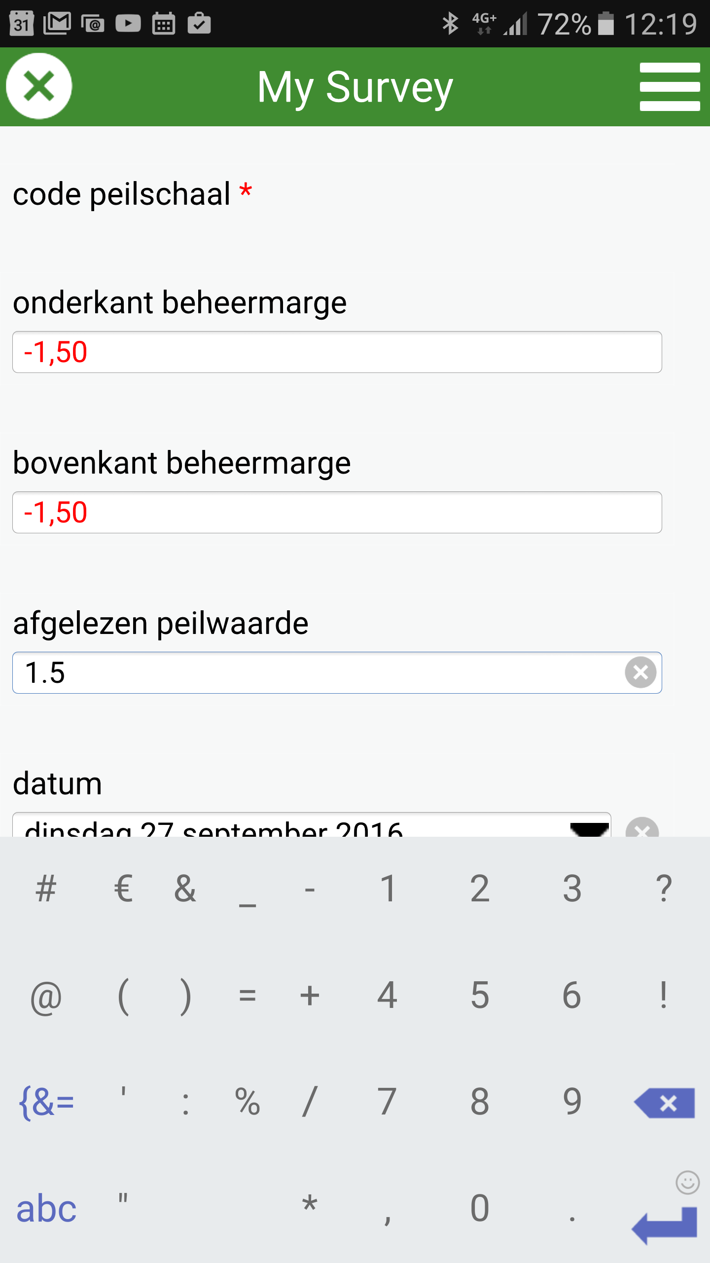

2. When I click the custom URL link it opens up the correct form and passes on all data correctly apart from the decimal data. It does fill it in in Survey123, but flags it as incorrect (red) because it uses commas instead of points.

I found a workaround, but it's not really feasable for us. If I change the language on my device from dutch to english the above method works fine. I'm not gonna be able to force all our workers to change their devices to english language though.

On android I'm not able to copy paste-from collector, but when I do from my work computer I get te following link:
arcgis-survey123:///?itemID=c077e9a944a940b7a1ba74989b518282&field:peilschaal=11265PS&field:minpeil=0.200000002980232&field:maxpeil=0.200000002980232
That is from an AGOL organisation that's set to Dutch language and region.
