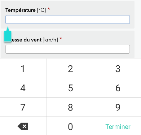

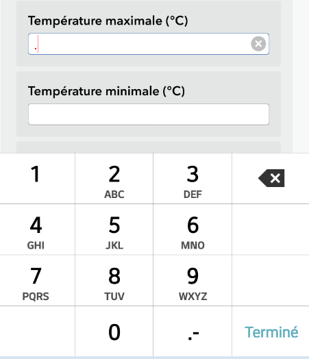

Here are the screenshot of both devices when they are trying to enter a minus sign in the field:
Device 1. Question of type Integer:
Device 2. Question of type decimal:
Are asked the user of device 2 to hold the (.-) button, but only the dot appear when doing so.

Here is the actual keyboard they see when trying to enter data for this Field:

I edited the question to add new screenshots.

While I'm not sure what Android device your workers are using, on the device I'm testing on (Samsung Galaxy S8) that '.-' button produces a minus sign if you press twice on the button, rather than press and hold.
As to the button not appearing on integer questions, that may be a device-specific issue, as the '.-' button is present for integer questions on other devices, including other Androids. This could be solved by the use of a third-party Android keyboard.

I can confirm that pressing Twice on the ( .- ) button actualy shows a minus sign on device 2. Thank you!
For device 1. I will try using a decimal question and see how it goes.. not optimal but workable.
