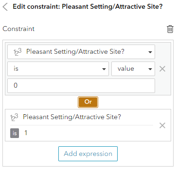

Hello,
is it possible in ArcGIS Survey123 Web Designer to limit an entry in a Number field to 1 OR 0.
The constraint I have set below in example image still allows entries such as 00, 001 etc etc.
Thanks

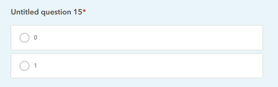

Ah I see, sorry about that, instead, would it be possible to use radio buttons to create a choice question, I attempted this here and it returned only 1 or 0 depending on the choice:
This is a single select question:

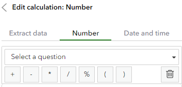

Hi @CodyPatterson yes I think because I'm trying to add numbers from a text field it cannot work. Under the Calculation in the Number field using Number the question does not appear in the dropdown.
The goal originally was to have Single select type questions with "Yes" and "No" entries. Yes would = 1 No would = 0.  However it didn't appear to be possible to tot up a total score in the Web Designer.  Hence my workaround of just using 1 and 0 now.
