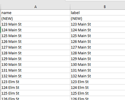

The issue you are having is that street field has a label of 123 main but the name is just 1.  The name is what is stored.  So when it does a lookup on 1 it finds nothing.  You really do not want to store just a 1 in your data.  I suggest change it to name and label the same
See attached.  Hope that helps
ZenMasterZeke
Awesome, works great now. Thanks @DougBrowning
