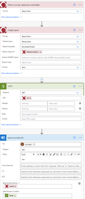

While I still recommend checking out my guide since it has a ton of best practices, here is a crash coarse to get you started:
  1. Ignore the Red color of my "Create Report" step. Yours will be Green. I just customized mine.
  2. Always choose "... of the first result file" when referencing that Create Report step. E.g.:
  3. In the Create Report step, you want "Feature object ID" to be the "ObjectID" of your survey submission.
Here is the most basic of flows to attach a Feature Report to an email (again, not recommended to go this bare-bones. This just illustrates how few steps you need):
