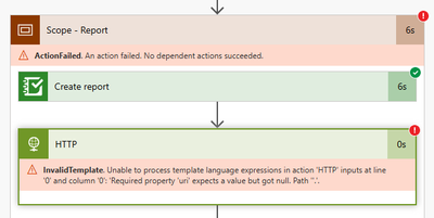

AshleyPeters
I didn't even think to look further into the cancelled runs to see if there was an error. I'm still very new to Power Automate. This is what it says:
