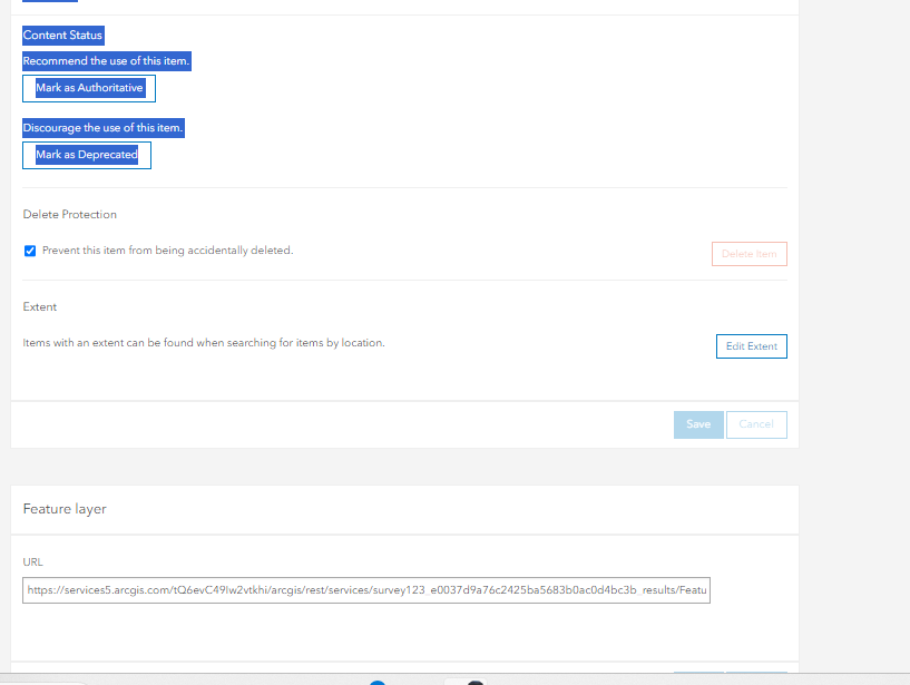

I was trying , but there is no ADD FIELD tab like there is on other Layers... and in Settings I am not given the option to make the layer editable, in fact none of those options appear

Looks like you are trying to edit the view. Go to the actual layer instead.  123 makes these views by default but they are just pointers.  Look in AGOL you will see it.
