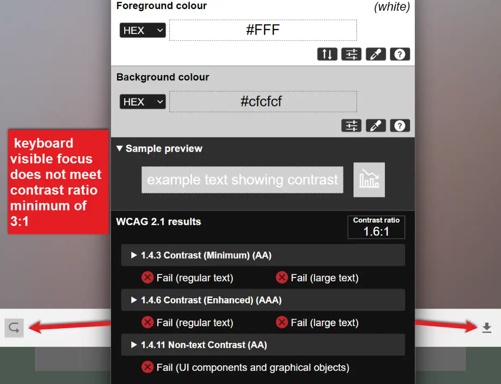

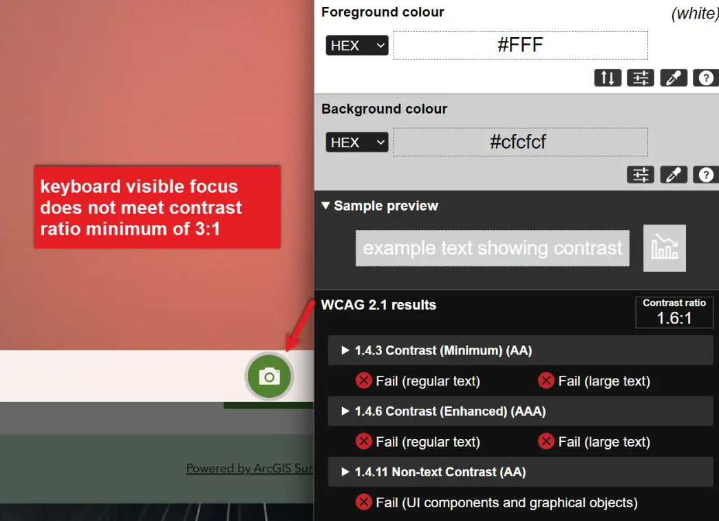

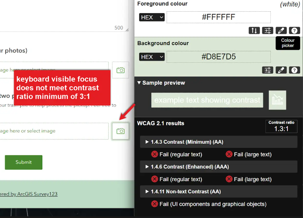

We got our Survey123 tested and there were a few accessibility issues flagged pertaining to keyboard visible focus and color contrast for certain elements. (photo examples below)
I am inquiring here if anyone knows of the user/client-side ability to adjust these color contrast issues, or if this is something that is built-in to Survey123 and needs to be logged with Esri.

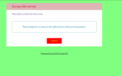

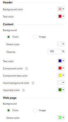

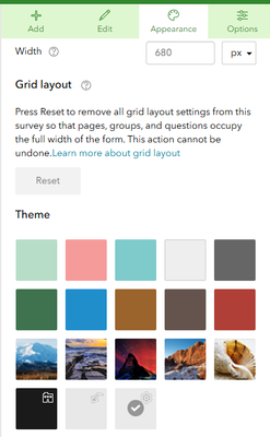

This should be pretty easy.
Go to "Appearance", then under "Theme", hit the one with a little gear on it.
You'll be able to customize a bunch
I'm not sure it'll hit all of the things on your list, but it should hit most of them.
See this page for doing it in Connect: https://doc.arcgis.com/en/survey123/desktop/create-surveys/styleyourform.htm#:~:text=that%20choice%2...
Tiff
Hi @AlfredBaldenweck, I did see some of these style settings and did play around with it a bit. unfortunately in Connect it only supports the foundational aspects of the form like header, body, background, even the input text or background, and footer. Nothing seems to point to being able to adjust some secondary colors such as the light green or gray within the camera/photo question.
