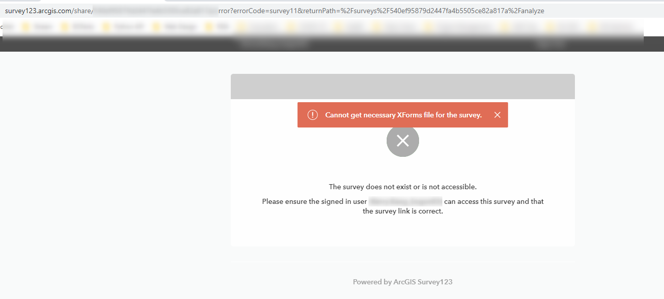

Hello @Ismael and the team,
I started having some issues today to access the survey123 setting pages. I don't access the page everyday so hard to tell when it started, but I have not encountered any of this error before. I was wondering if it is related to the new release?
Here is some more information:
- I am the survey owner
- Survey has not been moved to another folder
- Some survey setting is open without issues but most of them show the errors in the image below
- I cleared cache and started with a new browser
- It looks like the surveys that have errors were built on 3.12 and had version lock. I could open setting pages for some surveys that were built on 3.10, 3.11 or even 3.1. Or set up to use the latest version.

Do you have audio questions in the XLSForm? There are a couple of other threads where this has been confirmed.
Ruth_JiatengXu
Hi @KerryKang @Mondi_GIS
There is an known regression issue with the audio and video questions, if your survey contains an audio or video question, then the collaborate, analyze, data, settings pages, and the web app will return error "the survey does not exist or is not accessible". This issue will be fixed in the upcoming hotfix, and I will reply to this post when the fix is ready.
If your survey does not contain audio or video question, please let us know in the comment.
Thanks,
Ruth

Ruth_JiatengXu
Hi @Mondi_GIS @KerryKang
The fix is already on production website. Your surveys with audio question should be loaded as expected on website and web app.
Thanks,
Ruth
