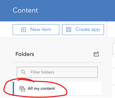

My only thought is that your survey was "hiding" in a folder. When searching in your content, make sure you have "All my content" selected and then search for it.

I did search through "all my content" and couldn't find it hiding in any folders, unfortunately. This survey form is in deep hiding

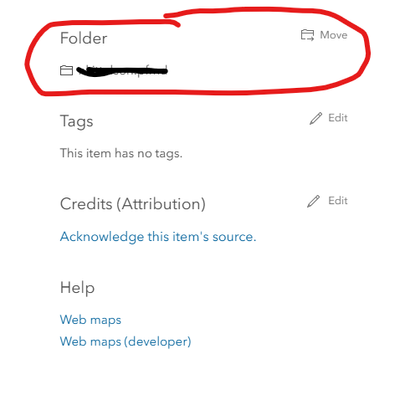

Neal_t_k
If you can get to the Overview page from searching my organization,  that page has the folder location on it at the bottom:

I found the overview page for my form, but it does not list a folder. It does give me an ID number (ID: 16885220c33c4f79a31ba0e3811cce59).
