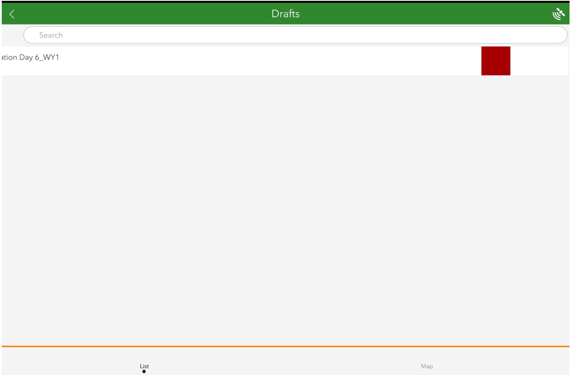

In Drafts no delete or any button
No repeat arrows shown

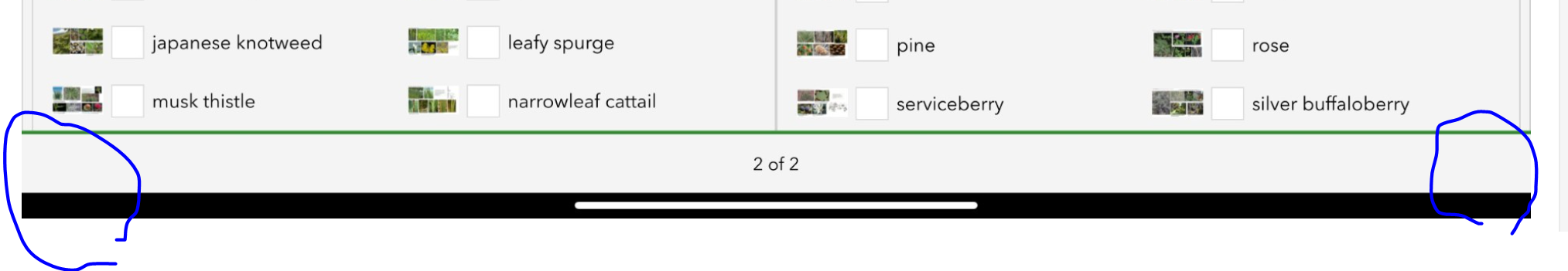

Also have checkboxes and such not responsive to taps.

For "...that loses all its buttons" does the app initially start with the icons then eventually they disappear or are the icons always missing from initial launch?
They are not there on initial launch.
Note the buttons actually still work you just cannot see them.
