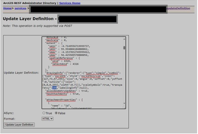

FrancisCorbett
Yes this was annoying me too. I found going to the Admin REST endpoint  of the HFS and changing the transparency in the drawinginfo renderer to 100% (making sure to remove lastediteddate) worked, using the drawingInfo:"currentLayer" method in the report template. The usual caveats about potentially breaking things. Nice and clean maps in the report.Admin REST endpointAdmin REST endpoint
