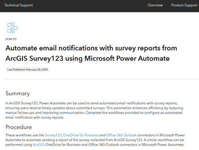

You can likely do that with Power Automate. I know you can with default email addresses, not as sure about one coming from the survey itself.
SMauri
Automate email notifications with survey reports from ArcGIS Survey123 using Microsoft Power Automate from Esri support
https://support.esri.com/en-us/knowledge-base/how-to-automate-email-notifications-with-survey-report...
