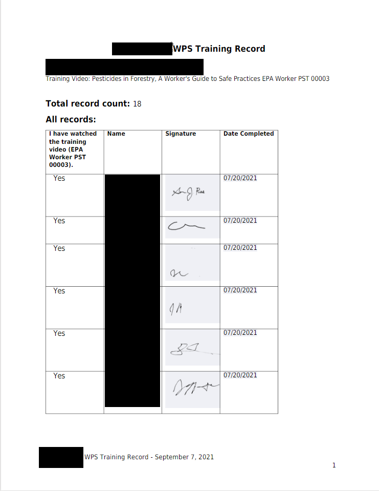

I would like to be able to printing images or maps in a summary section, something like this:
$<$summary>
${#SurveyName}${FotoAttachment}${/}

Can you please share a screenshot of your previous report (with sample data)? Are signature pictures are included in a table? If not, you should be able to achieve the goal by using multiple individual reports instead.
SaWaRise
Yes the signature "pictures" are in the summary report.  It is the required format.
ZhifangWang
Thanks@SaWaRise for the screenshot, this helps us understand the requirement of your workflow.

ZhifangWang
@AngelRomoSandoval ,
No, this is still not available. When you print a summary report with a repeat that contains a map image or attachment info that needs download the binary, the following error message will show up: "Failed to parse <expression in italic> since printing a map/image or accessing attachment binary is not allowed when iterating records inside a summary section."

LMedeirosUI
@ZhifangWang Will this be addressed? The summary function allows people to group and collect data over time without having to scroll through multiple individual records. I use S123 to collect data on the same 100 individuals over the course of a year (or longer). Each individual is uniquely identified, but not sampled in the same order. I use the summary report to group the data by the unique ID and sort it by date. Many of the dates have attached images, which are crucial to my work of following morphological changes over time. The individual reports do not allow me to organize my data in such a way that is useful. Please bring back the ability to include images in summary reports.
If individual reports can be used in the manner I am describing, please let me know.
EgleAdmin
The workflow that @SaWaRise  described on ‎07-29-2022 11:04 AM "Yes the signature "pictures" are in the summary report.  It is the required format." is exactly what we would like to accomplish. @ZhifangWang can you provide an update on this workflow implementation? Thanks!
