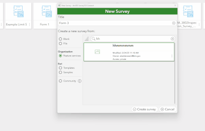

I have feature layer that points to a service in another portal. (It is my service and I have full power over it.)
What I'd like to do is use Connect to create a survey from this feature layer so that, for example, I can serve it out through ArcGIS Online but have the original table still live on my enterprise portal.
As it currently stands, when I try to do this, I get a "token required" error.
